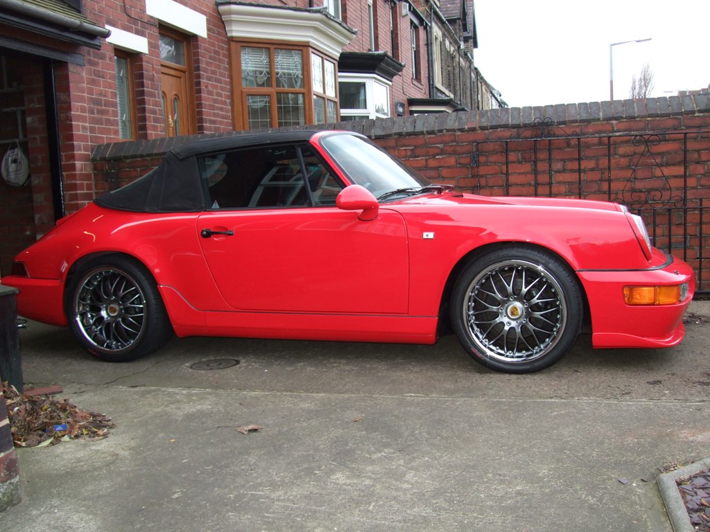

Thanks for the photo Lee, it looks great.
Also Kevin, great looking car, is that a turbo body? and those wheels look like Cup 2's with polished rims??

They're not Cup 2's. Look like Rufs to me.
911kev
ORIGINAL: Dekker
Narrow bodied Carrera 2 with 18" Ruf Speedline wheels. They were silver but had the centres powder coated black and the rim polished.
