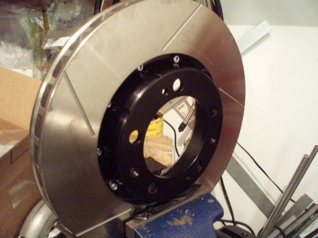

My friend have fabricated 951 hat for Big Red applications. It allows you to use 993 Turbo floting disk (drilled) under 951's. He have done them both old & new ET cars.
Old ET version:
