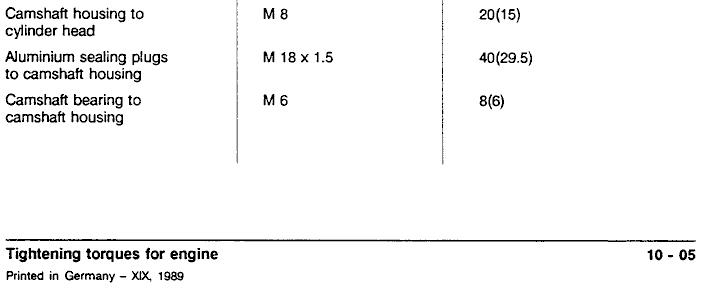

cam box bolts on 1987 2.5 944
Tom Moss
sorry but I'm new to this, and don't quite know how this works. Just had to replace a collapsed cam follower but I don't know the torque down setting for the 15 cam box bolts. Can anyone tell me for sure?
