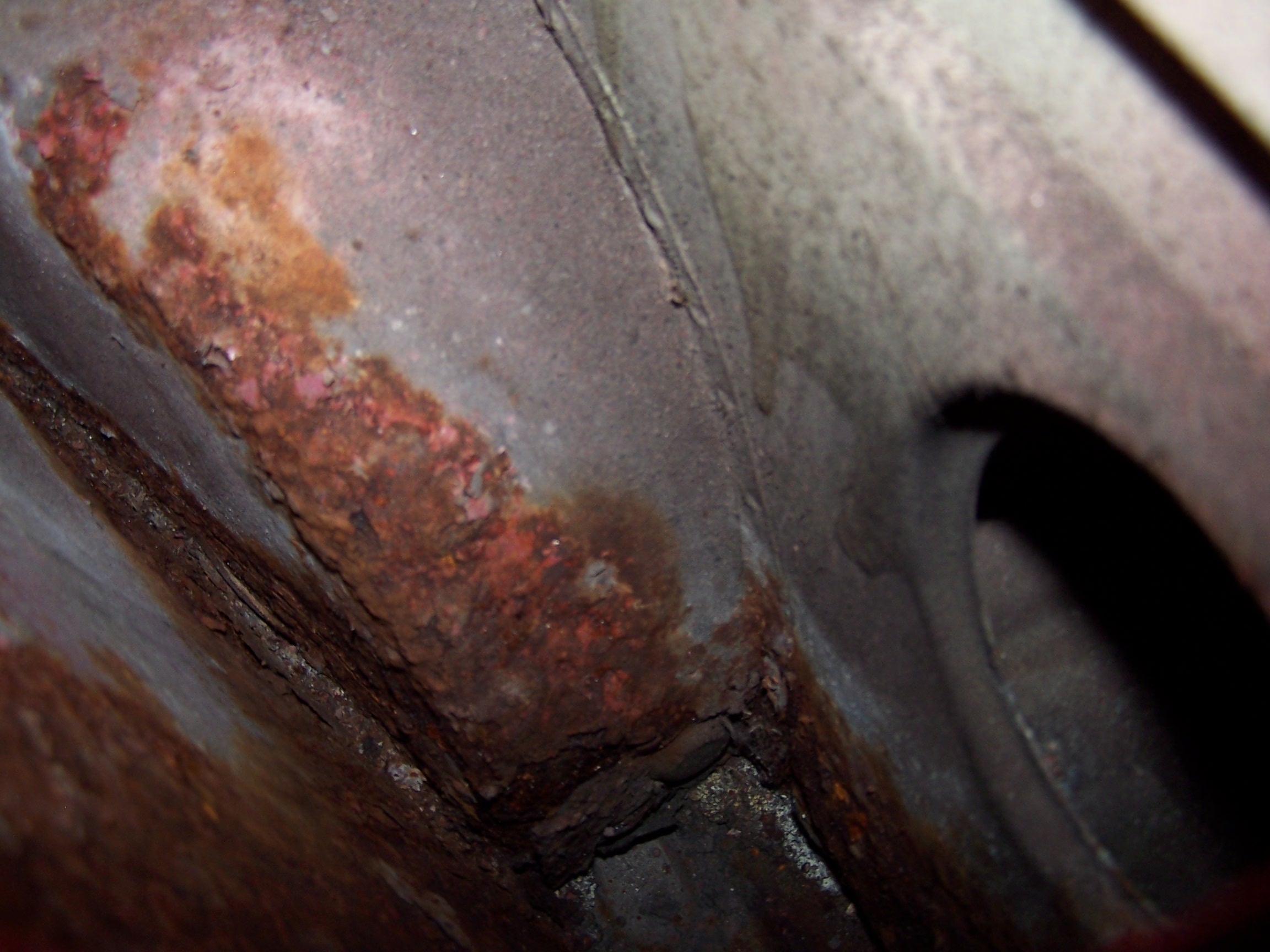

When the black vent is popped out, the hole is big enough to get a camera (or phone) into. It's easy to see the rear corner of the sills, directly below the vent, which is where the problems will be evident. What you want is a load of sticky yellow stuff, showing it's been waxoyled, and no more than a small amount of surface rust. Bad corrosion, or even daylight, means new sills, reapirs to inner sills, and a bill for up to ÂŁ1000 per side, depending on how permanent a repair you want. You can get a picture of the whole sill length from the vent, just don't drop the camera. [;)]
This is a pic of a sill that needs attention, but isn't anywhere near MOT failure yet (and wasn't a year later). This is about the limit of what I'd call "normal", a car that's going to be worth repairing without going mad on costs, as long as it's priced accordingly.

Sticking a digi camera in the sill is a good idea- I did that recently with my 968 and here's what it looked like inside:
You can see a bit of surface rust, towards the back, but towards the front, it's all fine. I've sprayed in some Valvoline Tectyl ML, which is the cavity wax Porsche uses AFAIK.
Wow thats the cleanest inside shot I've seen, don't even want to see mine lol.
