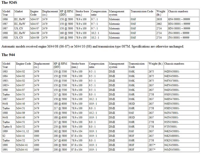

The early 924S 1986-1987 were 150bhp and ran a compression ratio of 9.7:1 which is actually a higher ratio than the 944 150bhp from 1983-1986 which ran a ratio 0f 9.5:1. The later 924S 1988 with 160bhp ran a ratio of 10.2:1 the same as later 944s
So working on that basis if a 924S 9.7:1 can run on 95 fuel then I would have to presume a 1985 944 with a ration of 9.5:1 would have no issues running 95RON unleaded.
Thats an interesting table, where is it from?
My 944 book by Peter Morgan shows very different figures! ie 1982-5 Euro models 10.6:1 cr 163bhp DIN @ 5800 rpm.
Would like to know more, I've always 160 - 165 quoted for the 2.5 n/a models.
Mike
Whilst Im not going to argue with what David is saying broadly (certainly I follow his reasoning), the series one 944 didnt have 150bhp, it had 163bhp. Perhaps the compression ration figures belong with the American power output figures?
The more I look at that table the less it makes sense. The early cars have always been quoted at 163 bhp and have stickers in the fuel caps saying 98RON - this would not be needed if they were only 9.5 : 1.
Also the oval dash cars had lower c/r to run on 95RON with better engine management accounting for the losses keeping the output the same - this is for Euro models.

Forgetting the compression ration discussion (I agree the list may be tainted by US spec stuff) and back to your question I found this
The official memo from Porsche states 944 1982-85 must use 98 (97) ron only and cannot be adjusted so super unleaded is preferable or if not available use L R P With any Porsche, lead is not the issue its the octane rating As a point of interest the only water cooled Porsche that will not run on regular unleaded is 944 1982-85 (source; Porsche tec. bulletin 25/05/99) regards Bert Gear - 20th June, 2000 which may answer it came from here​
