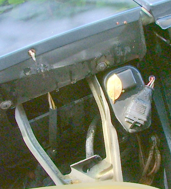

Here's a strange one: I had the headlights on yesterday and when I switched 'em off again they wouldn't pop down properly. The headlights lowered, then popped back up, then down, then up "¦ you get the idea.
They eventually shut down properly, but only after quite a few attempts.
Does anyone have a clue what could have caused that? Bad connection somewhere? Relay in need of replacement?

Also check the mechanism isn't catching anywhere (and be careful of your fingers [;)] ) -maybe disconnect the battery first...
I had a similar problem on the 924 where one of the water hoses was jamming the lights mechanism.

A quick check in the garage seems to show bugger all wrong with them. Hopefully it was a freak occurance, maybe caused by debris (I was out on a hoon at the time). I'll replace the relay anyway out of paranoia.
+1 with disconnecting the battery before shoving your hands down there.
I would remove and clean the earthing point and connectors. I believe they are down the front passenger H/lamp well with the horn and lighting ground points.
It's a dirty position wheel on the motor - a simple contacting strip that keeps the motor moving until the lights reach one or other of their positions. A bit fiddly but easy enough with some contact cleaner.
I wouldn't faf around disconnecting the battery, the motor is separately fused so just pull that.
