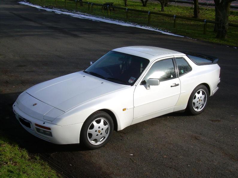

Apologies for butting in without an introductory first post but this is a subject which is about to be dear to my heart too. My Turbo (pic attached if I have done it right) has recently had a thorough mechanical go-through and general survey by Barry Hart and his splendid fellows at Hartech and they spotted a similar bit of inside-out sill corrosion which will need attention soon before it gets any worse.
