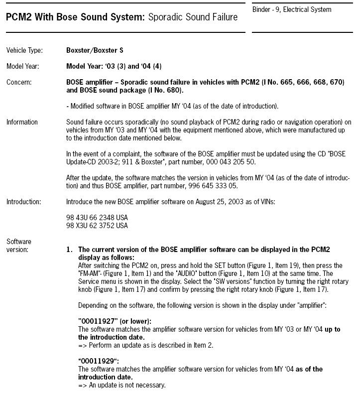

I wonder if it might be as per attached. Worth checking the software version. If you need the update CD let me know, as I have a copy.
Hi Thanks ...looks very similar!
However, our car doesn't have the Bose system. Appreciate the response,
