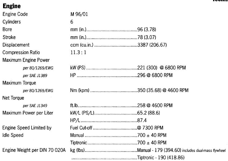

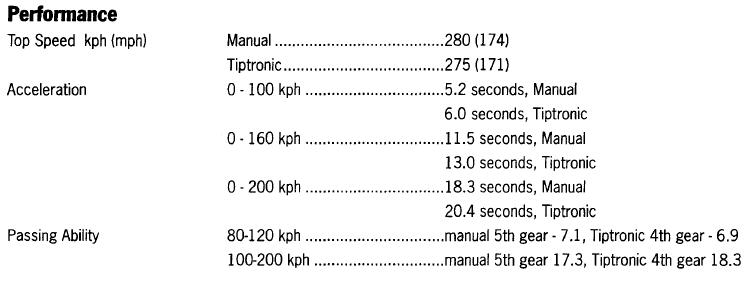

I keep seeing different figures quoted for the 3.4 Carrera 2, can any one provide some proper official figures and perhaps what your real world experiences are and what you guys have achieved on rolling road, 1/4 mile times and 0-60
This is from the 1998 Service Information Technik. Doesn't it give figures in the Driver's handbook?
Various magazines have published sub 5 second times and faster 1/4 miles. I'm sure as engines loosen up these faster times can be achieved. Also 0-60 v 0-100km/h are also different.

Exactly, but people tend to equate (round down) 0-100 to 0-60 instead of 62. That extra 2 can make a little difference [;)]
ORIGINAL: Mike IRL
Apparently a lot, knocks off some 0.2 sec
