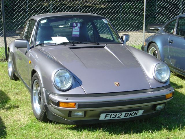

My 3.2 is a 1988 model, diamond blue metallic, black leather interior. No mods.?(hopefully the picture has attached it self)
Mileage is 124k.
Paid 14.5k to a dealer 2 years ago for it so looking in the region of 12.5k
Has been very realiable (1 dme relay failure last year thats all thats ever gone wrong).
Spent 1k on bodywork in first year tidying things up (bubbles under the bonnet badge and above rear light cluster).
