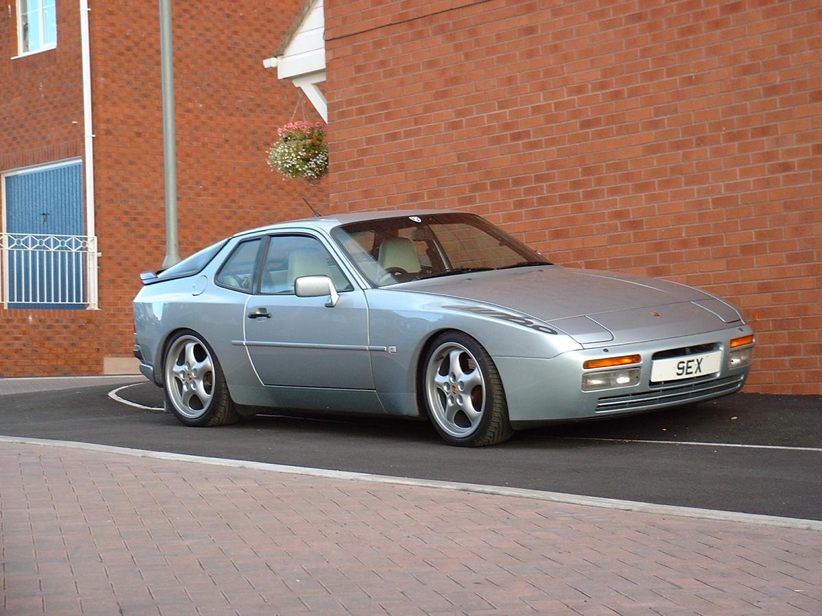

I am currently driving on 18inch turbo cups on a completely standard set up.With Pilot sports all round, I have no problem with tracking. With the Pirelli's that the wheels came with second hand, the steering wandered all over the place like a mad woman's excement.
The only problem i have had was that the wheel arches need to be fully rolled to accommodate the 265/30 rears. The 285 rears are far too wide and will foul the passenger side wheel arch to the point of damaging the body and destroying the tyre. (thank you Mr Porsche Specialist, so much for expert knowledge).
If you are apt to getting airbourne you may still connect the inside wheel arch though if you go for 10' rears with 265 width tyres.(Which may be the least of your worries. actually).
It's still on the car, yes. It actually belongs to a mate who deals in cherished numbers.
i have 265 tyres on the rear of my 944s and have not had to roll the arches to accomodate.
love the look of the 18s on the car they just make it a lot more modern looking ;)
