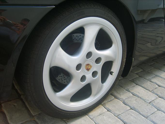

Well, pleased to report on a very successful day, the paint code is Porsche 9A1 Sterling silver metallic.
I resprayed the outer rims on both rear wheels this afternoon and am struggling to see any sign of mis-match!
I bought a 1/4 litre of 2K base coat and used a 2K clear lacquer, and now it show up the rest of the wheel, hopefully a good mop and polish on the rest of the wheel will have it sorted tomorrow.
Will post a picture if I can work out how.....
Looks like I might have worked out how to post a picture......
Well done Simon! (Wheel job as well as the photo attachment!).
Nice job. Did you remove the tyres, or mask them?
