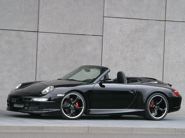

Which techart rims are they? Nothing wrong with them poking ut a bit further on the rear if you have the clearance!
These are the rims.
They are coming off a 996 not 997 like the picture.
I think they are formula 2s. not sure though. Will find out more today.
I think they look awesome, but if they dont fit will have to give them a miss.
They'd look great on your car! They should also be relatively lightweight for 19s if genuine tech arts. Worst case scenario roll the arches if you love the rims? Are you on standard suspension?

yes i quite like them!![:D]
Standard suspension. i just wasa not sure if they would stick out or not.
