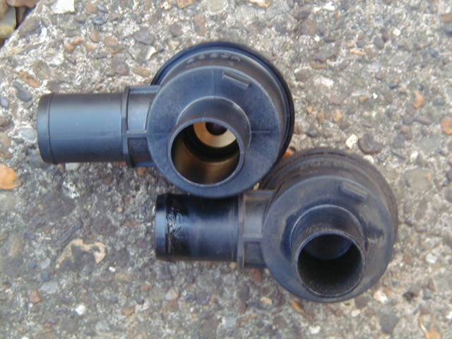

I got one from Silverstone OPC a few months ago for £38.94 + Vat after my 10% club discount. The part number is 993.110.337.50
Here's a picture of both the old and new:
Yes Paul its the same one thats fitted to the Saab with the metal diaphram, but its about £10 cheaper from SAAB than Porsche!!
