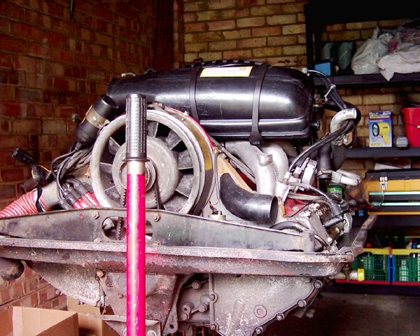

Good Luck HP can't advise about the spanner but I'm sure someone will chip in , try a search on ebay under tools. Here's a pic of my project , it's now stripped down to the long block, drop me a line if you need a second head. I can't wait to post a pic with it looking restored.
