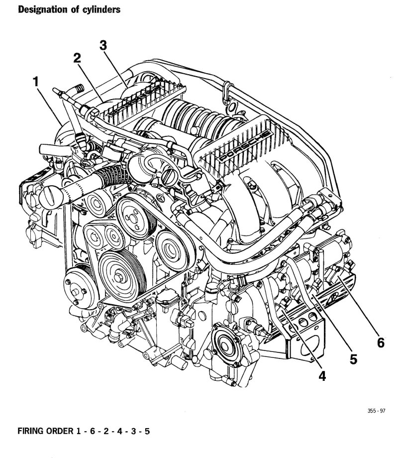

can someone tell me what the engine layout of the 3.4 is. I want to know which order the cylinders are lined up in as i look down on the engine.
eg
1 2
3 4
5 6
or
1 4
2 5
3 6
Here you go:
