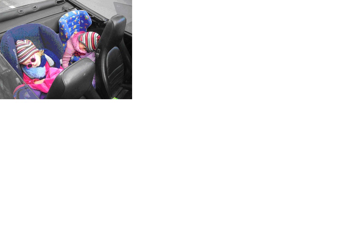

P.S. 2point ones are okay with Porsche child seats.......plus some others
