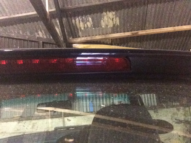

I can probably take a better picture tomorrow when the light is better. Here is my 96 coupe.
Ian.

Photographing a Midnight Blue car up close is rather challenging! Fortunately able to over expose the pictures using Photoshop to highlight the profile. This is on a 96 coupe that came with the high brake light from the factory.
Ian.
