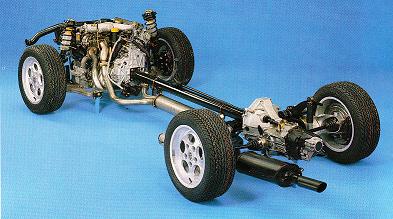

Just reading another post about winter driving and the 50/50 weight distribution thing came into my mind. Looking at a cut away the big lump at the front looks a lot heavier then the lump at the back. Wouldn't have thought the body add no extra weight to the rear, so it's down to fuel in the tank to make up the extra.
Am I missing soething?

No - its accurate.
One of the 944 books I have has a couple of independant tests where they've corner weighted the cars - I'm pretty sure one even came out as 49% front, 51% rear.
Battery in boot.
Exhaust.
More glass towards the back
Dead body in boot. Erm. [&:]
I'm having one of those days, but I didn't see the gearbox mentioned, if it was I apologise profusely - I'm doing my graduates yearly reviews and I think my head is about to explode. [:eek:]
Oh and on the early lux's the battery is in the front so that may add more weight, see what I did there, to your arguement.
I'll get my coat
The engine is not all in front of the wheels (proving its not an audi [;)] )
rear beam, torsion bars,

Don't forget the driver + passenger at say 150 - 200kg together.

The body does weight enough and the gearbox is not exactly that light. Also there is the fuel tank. There is more in the rear of the car than in a BMW which is supposed to be 50/50 weight distribution and all they have in the rear in terms of heavy ironwork is a small differential. I've read that a 944 is actually 48/52 distribution so ever so slightly rearward biased.
