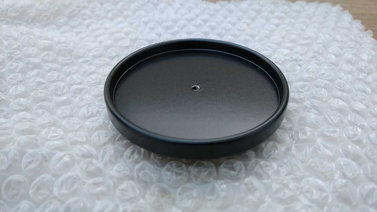

Powder Coating
For the final finish, I selected a matt black powder coating (Polyester) at 100 microns, to match the appearance of the painted matt black on my 50th Anniversary wheels and the job was undertaken as a favour by a local coating company.

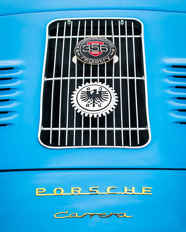

The ADAC (similar to our AA), also supplied their own members with badges:
![porsche-356-grille-badge.jpg](https://i.postimg.cc/j2p5NQzY/porsche-356-grille-badge.jpg)

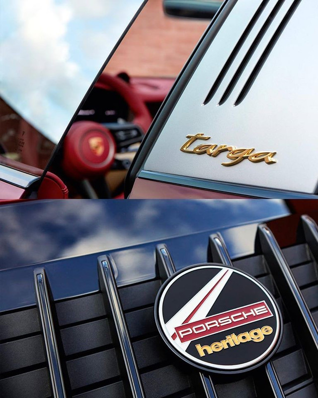

Porsche have created limited edition badges at various times throughout their history, to commemorate events or cars. Most recently, a new badge was created for the heritage edition of the 992 Targa 4S:
![Porsche-911-Targa-4-S-Heritage-Design-Edition-16.jpg](https://i.postimg.cc/bYWdK84V/Porsche-911-Targa-4-S-Heritage-Design-Edition-16.jpg)

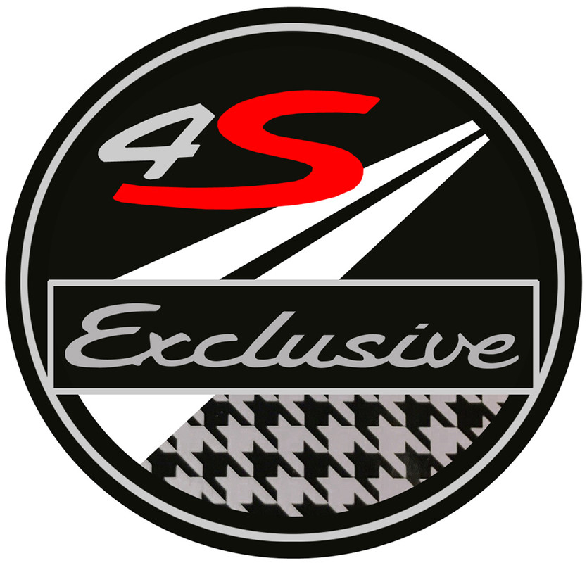

Emblem Design
Having committed my initial thoughts to paper, I then spent a couple of weeks collecting the imagery and re-drawing artwork for the various design elements. The idea being to incorporate the unique parts of my own car, in order to create a bespoke badge for a bespoke car.
![4-S-Exclusive-Grill-Badge-Photoshop-Mockup80mm.jpg](https://i.postimg.cc/prn49DWj/4-S-Exclusive-Grill-Badge-Photoshop-Mockup80mm.jpg)

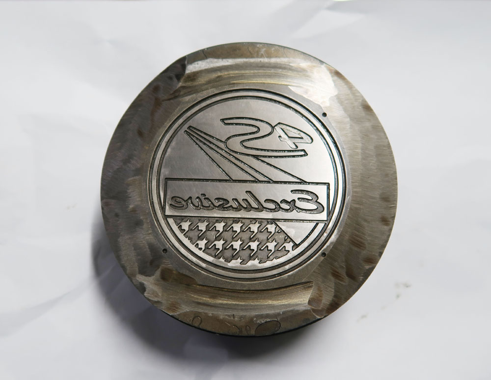

A die was manufactured, ready to strike the badge:
![tooling.jpg](https://i.postimg.cc/DZtFYfmq/tooling.jpg)
To meet my requirements, I specified a brass alloy (with suitable metallurgy for this sort of working) with the final size to be 80mm diameter, with a thickness of 4mm. Various areas of the design would be filled with vitreous enamel and the remaining metal electroplated in a matt finish chrome.

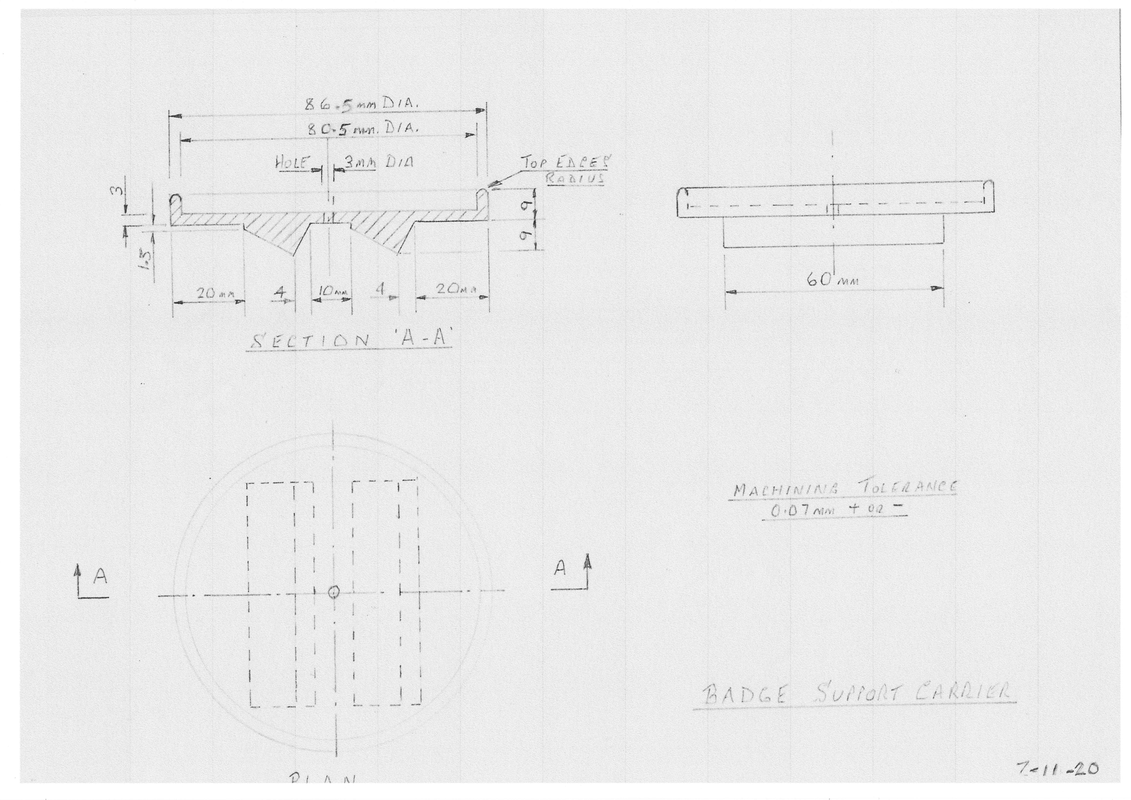

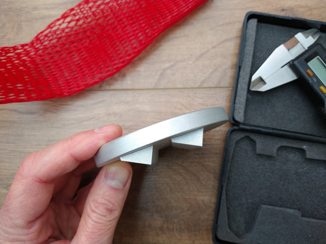

To begin with I had considered amending the badge, to attach angled mountings to the rear during manufacture but in the end I decided to create a machined carrier in 6082 aluminium, to mount onto the grille slats with 3M tape. Arriving at the final dimensions took some time and I made several wooden models - where I imagine the factory would now use a 3D laser scanner and CAD software...
![Badge-Carrier-071120-Darkened.png](https://i.postimg.cc/QMzrHNQR/Badge-Carrier-071120-Darkened.png)

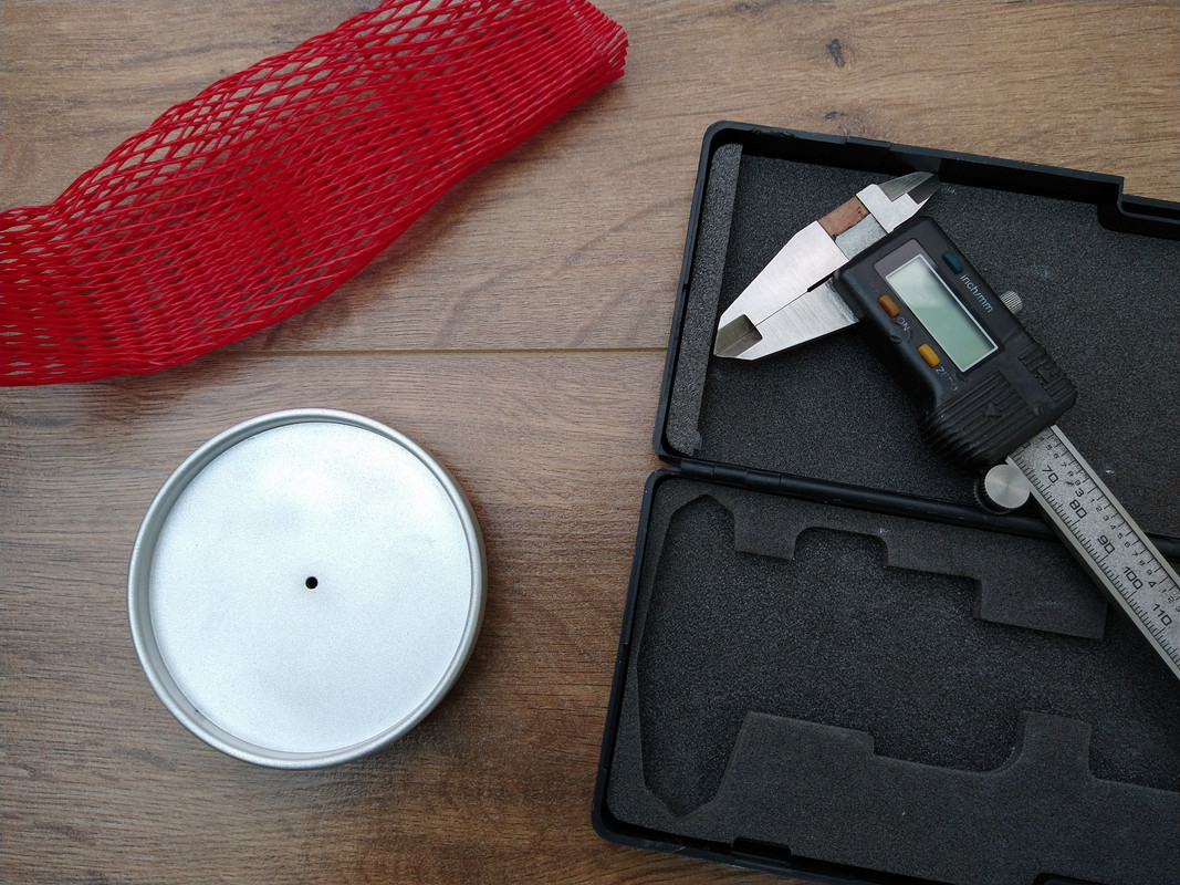

Another helpful supplier, made a great job of the machining and finished the carrier with glass bead blasting, as requested:
![IMG-20201204-113658162.jpg](https://i.postimg.cc/HkBm19VW/IMG-20201204-113658162.jpg)
![IMG-20201204-113741514.jpg](https://i.postimg.cc/GptCLTyF/IMG-20201204-113741514.jpg)
![IMG-20201204-113840355.jpg](https://i.postimg.cc/sgVzLNf0/IMG-20201204-113840355.jpg)
A really top job!
![IMG-20201217-WA0004.jpg](https://i.postimg.cc/76zjh3Y2/IMG-20201217-WA0004.jpg)

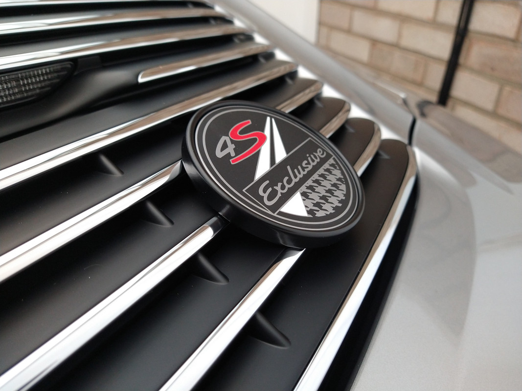

With the help of a heat gun and pyrometer strips, I mounted the carrier to the car and the badge to the carrier (to ensure correct alignment with the slats), with high-bond 3M tape.
It probably isn't everyone's cup of tea but I like it and am glad I made the effort to create something unique.
![IMG-20201219-104504066-2.jpg](https://i.postimg.cc/s226xFDZ/IMG-20201219-104504066-2.jpg)
![IMG-20201219-104605431.jpg](https://i.postimg.cc/YSDtYzHD/IMG-20201219-104605431.jpg)
