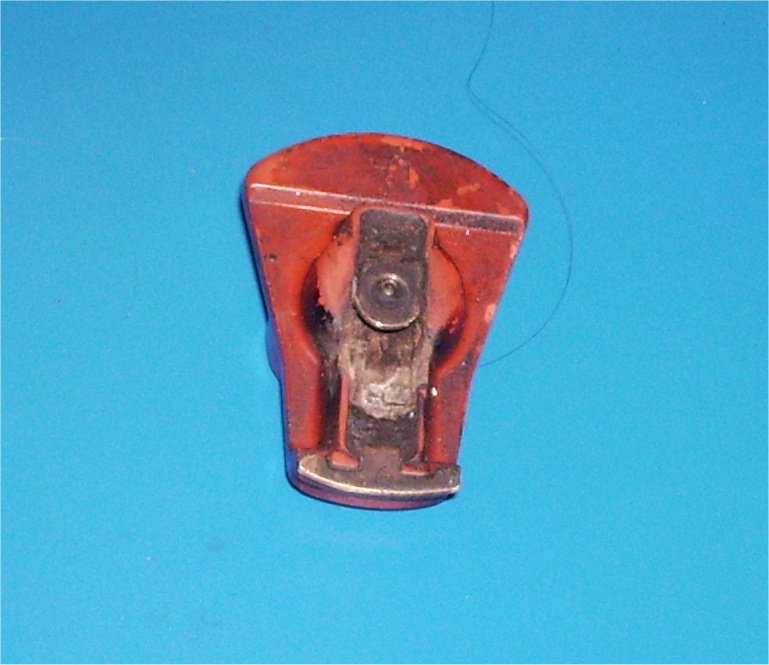

Colin,
Luckily the job was to replace the rotor arm so the new one was sat there waiting to go on. Had it just been a case of needing to remove the arm to do something else (clean it etc) then breaking it would have been a pita.
The bakelite part broke quite easily, getting the brass part off was a swine.
The arm had disintegrated between the central contact and the end of the rotor arm. The spark was was being conducted through crap.
Picture attached, not a pretty sight!
