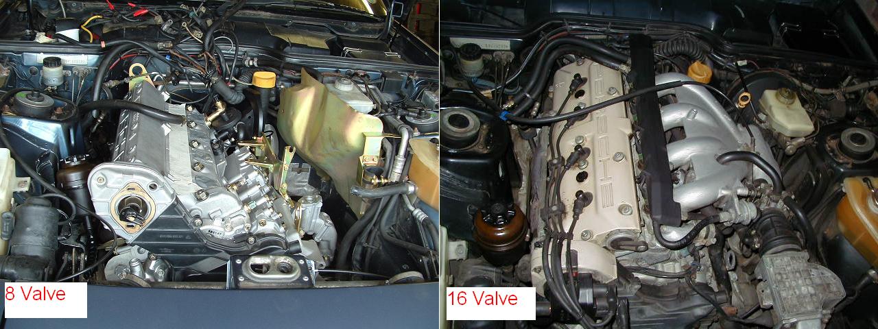

It is quite common as they are both the 'less usual' models and people get confused. The S was a 2.5 16v and the 1989 Lux was a 2.7 8v. It has been known for some Luxes to have the S and Ventiler badges stuck on them, this includes the 'S' in the pictures on the Titanic website I linked too [:eek:]
The easy way to tell is by looking at the engine pics below. The 8v head is on the left and the larger 16v on the right.
