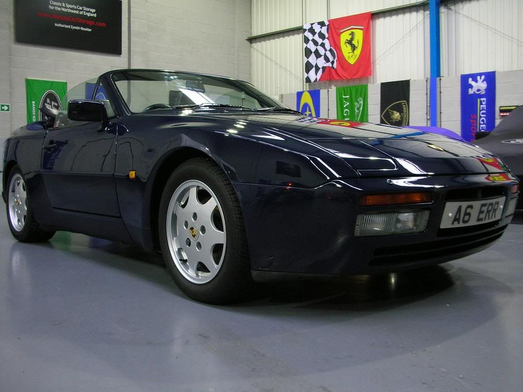

Hi, Just aquired an H Reg 1990 944s2 cab in blue that has a six speed box of a 928 plus 928 wing mirrors,door handles,steering wheel and bridge spoiler. Does anybody recognise this car? I believe it was first reg H2 DANL.

You're going to have to post pictures of a cab with a bridge spoiler, please!

Im guessing you mean a 6 speed gearbox from a 968 + mirrors + steering wheel. NOT a 928.?? And a "bridge" spoiler,,, On a cab...??? I dont think so..!!!!!!!!!!. If it has, well i suppose its personal taste...[8|][8|][8|]

I really am intrigued about this 'bridge spoiler'!

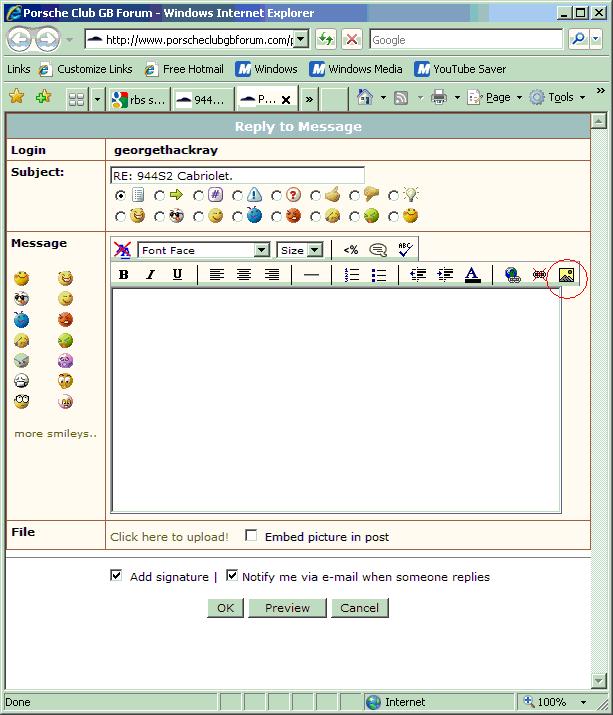

The best way is to upload it to something like Photobucket. When you've done that, there will be a few boxes underneath containing text. Copy the text from the 'Direct Link' box. It looks a bit like this:
http://i203.photobucket.com/albums/aa29/geeeteee/16-Finished2.jpg
Next, in your click the 'Add Image' button on the message editor.
(Circled in red on the image here), then paste the code into it. That's it!

The rear spoiler you have is an aftermarket job... NOT a 968 bridge spoiler....BUT all the other bits you mentioned are from a 968...
I seem to remember seeing your car for sale a while ago...
ORIGINAL: rogero
it's uploaded something, if it works will take some better angles
roger
He shoots, he scores. [:D]
Nice colour.
I haven't seen a bridge spoiler on a Cab before.
