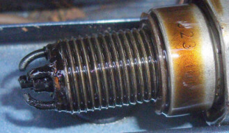

Running out of ideas now so decided to pull all the spark plugs which were new 500 miles ago.
Look what i found !
I filed the edges cleaned them up with spirit and popped them in the oven gas mark 3 [;)] put the plugs back in hot and with a jump from a spare battery she fired up.
It still took 5-6 minutes before the engine was firing smoothly on all pots so there are still some issues there somewhere but for now it runs and i celebrated with a spirited run up to the garage for some more gas[:D]

They look wet but serviceable.
I agree about the Italian method of drying out overfuelled plugs though [;)]

no they are not servicable otherwise the car would have started
I hope your plugs don't look like that[;)]
The main reason for posting the pictures to to show the oil. It looks like the cam cover gasket is leaking into a couple of plug tubes
