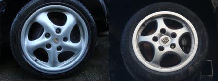

The wheels I'm looking at buying are in the picture below.
One the left that are from a Boxster and are Front: 7 x 17 ET55 Rear: 8.5 x 17 ET50. I'm not sure what the others are. Maybe they are C1 or C2's?

And they look like boxster twists? with 16" cup 1 on the right
