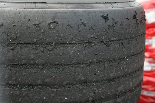

Struggling with the power of a turbo? Sorry about that. My only advice would be to never buy an S2 then ... This is what the rear tyres from my S2 looked like after a couple of (embarrassing) wheel-spin-in-5th-in-the-dry incidents:
(You don't want to know what my undercrackers looked like ... )

"Now, when I click my fingers you'll be wide awake and back in the room..."!!!!

OK Appleton - I'm watching you.
(And ignoring that comment!)
