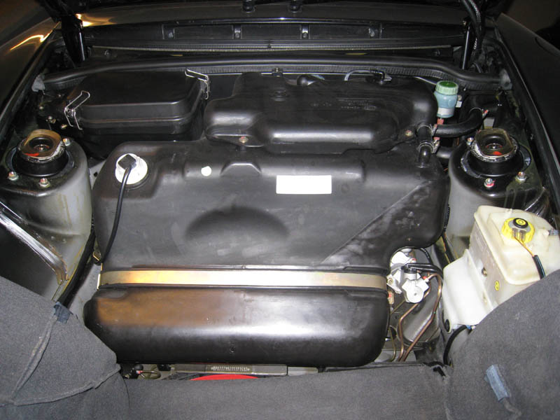

In trunk, when most is removed you can see grey/white paint on the sides ??
And some messy glue or something at the suspensionmounts + sides..
On my 993 C4 I can't remember any grey paint ?
So the question is: Has it been into some serious accident ?

Here is the picture..
Left + Right side have glue/mess of somekind
+ there is sprayed some grey/white paint..
Is this normal ?
Yellow messy stuff is rust protection, not from Porsche, owner had this done. (even under car)

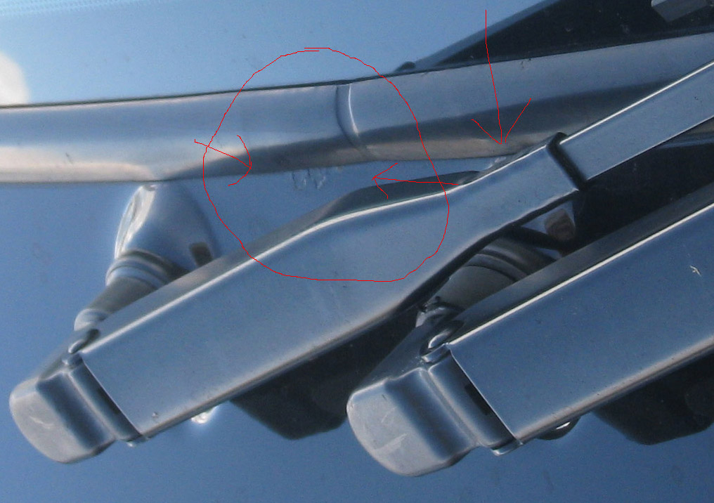

Is this a problem ( Rust mark.. )
Or is it just to lift the rubber and look ?

It seems Porsche didn't spray complete under the carpets etc. I have noticed this on a few and asked the question too!
The rust could be a real problem if not sorted correctly! Look more into to that! They do rust around the screens.

The rust looks like it has been tackled, but it is possibly a sign of some more serious damage lurking under the windscreen seal.
As for the luggage compartment, most 993's don't have a lot of paint in the areas that don't show (finances were a little tight with Porsche in the 90's!), so I wouldn't be concerned about this.

The corrosion near the windscreen seal is indicative of a lot more corrosion around the windscreen aperture. This is exactly how mine looked. I didn't look too bad until I had the windscreen removed. This revealed a lot more corrosion underneath.
Plan on about £500 to have the screen removed and the corrosion fixed properly.

This is how it looks when I asked him to check it out for me.
Doesn't look that bad ?
Just a tiny mark of rust, guess I can fix it without removing the windscreen ?
Will take a close look around seal, and see if there is more.
He says this is the only spot.
Is it hard to remove the seal around windscreen ?
Need any tools ?
Is it glued ?
Hard to install new seal ?

Right. To answer some of your questions.
1. Rust spot under windscreen/ rear screen.
This is a very common problem. Most 993s and 964s get this. It is not particularly serious if treated quickly and professionally. It looks from the photo as though yours has been "bodged" (attempted DIY repair). Total cost of repair ? Budget £300-£400.
The rubber strip peels off easily. That is not the problem. To do the job properly, you should remove the windscreen. That is bonded, and if it breaks during removal, the cost of a replacement windscreen is £1200, so make sure yours is insured before you have the job done.
2. White paint in boot.
This is totally normal. It just indicates the factory did not spray the boot with top coat. You should worry if this is not present.
