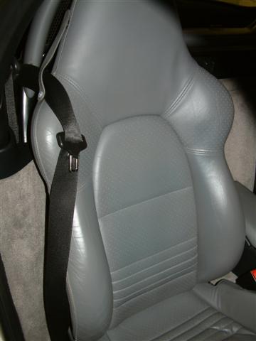

My sports seats have electric back adjustment, manual fore/aft, manual lifting up and down.
I find them very comfortable but im not very wide in the shoulder department.
Did 2100 miles in less than a week and all was fine.
Ive heard thatsome peeps arent happy with them in a boxster due to the seats not being low enough hence steering wheel in the knees, i cant say i find that a problem and im a 6'2" build.
Pic of mine attached
