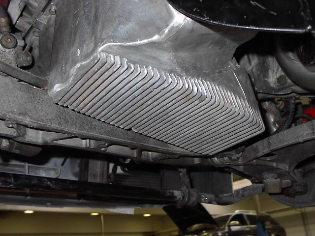

Sump is modifid as the engine is more vertical, and gearbox to torque tube connection is modified.

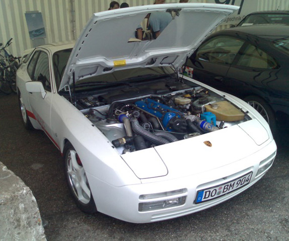

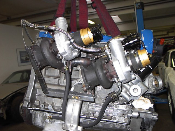

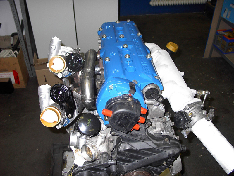

Glad you asked [;)] I didn't know either a rennlister spotted it and took a pic so I contacted 9ff to find out more. I have seen in the US some cars running the 16v engine vertically but only with a large single turbo. two smaller ones makes a lot more sense. I hope when it is finished it will appear on the 9ff website.
"We are finishing the car in the moment on the first dyno run we had around 370 HP. The standard gearbox has to changed so far that the connecting points have to be turned because the position the engine it self changed. The costs for a modification like this would be around 17.000,00 to 20.000,00 euro including installation and exhaust and full services of all gaskets. Let me know when you need more info.
The boost is around 0.9 bar for the 370HP. I am very sure that the turbo lag is much smaller than with a single turbo. I got to say that the car drives very clean with an very nice boost curve."
The pictures all came from 9ff with the exception of the front pic showing the bonnet so I guess they may have a solution for that soon. ( I actually quite like the hole but it wont be very practical in the winter)

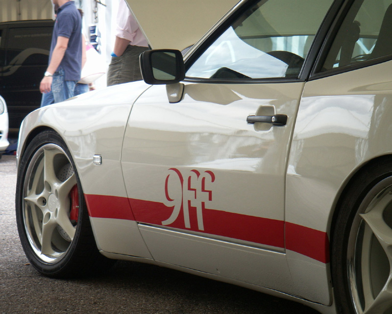

They are just the 18" 5-spoke carrera wheels off the 996/Boxster
Trust a Boxster owner to lay claim to something like that. [;)]

Daft question perhaps but are they running one turbo on two cylinders twice?
While I can see how a twin turbo would work on the Porsche 6 cylinder boxer engine - one turbo for three cylinders - I would have thought one turbo on two cylinders so close to the outlet would give a pulsed exhaust gas delivery which can't be ideal?

OOOhhhh I love the wheels, they look like the ones on Ricks car??? What are they?
Mark, I believe the boxster versions are much narrower. Probably best to keep them as 'space saver spares'
ROFLMFARO [:D] [:D] [:D] [:D]
