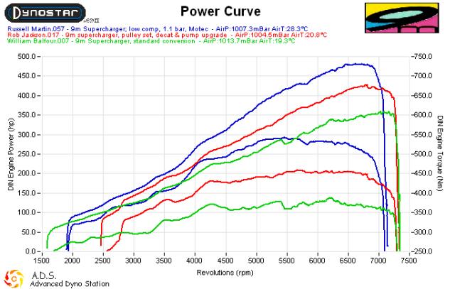

Thought that the genuine petrol heads amongst the 968 fraternity would enjoy seeing the results of our latest 968 supercharger development programme - the dyno graph below shows the power/torque of our standard 360hp conversion, our phase2 430bhp conversion (both running a standard engine) and finally our no-holds-barred package which runs low compression, Motec and a straight through exhaust on headers, conveniently running double the standard power output at 480bhp. Enjoy.

Your graphs and info I have read about 9M supercharger conversions leads me to ask, would a 944turbo not be better with the turbo replaced by a supercharger?
What are the pro's and con's given the 8 valve head, 2.5L capacity, wastgate, motronic, intercooler, exhaust system etc

Have seen the numbers and they are impressive, my own 944T has been Promaxed to derestrict it a bit, but my question was around whether a supercharger would bring advantages to a 944T over and above a turbo. Perhaps it needs both?[;)]
