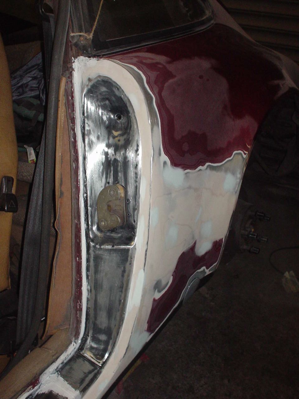

Update: The rear cross member has now been repaired, the rusty part of the quarter cut off and the replacement grafted on. Still a fair bit of work yet to do to get it ready for painting and the inside of the quarter needs under sealing but very pleased with the results so far. [:)]
