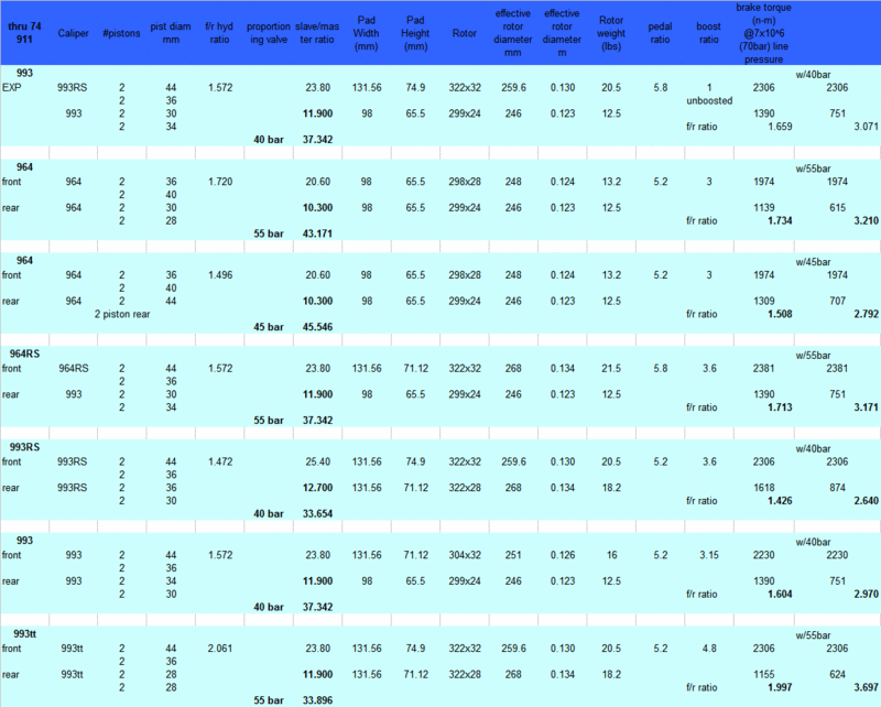

if you haven't seen this already, it's very useful.

I hadn't seen the Bill Gregary list Lawrence, thanks.
(edit:- I've just seen it's on the end of my pdf file, I'd never scrolled down that far.)
I have seen another one by Bill Vertburg.
