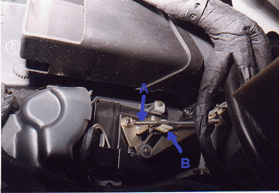

The heater fails to hot if it has a fault. It could be the controls or pretty much anything else in the system too. A common failure is the plastic clips that hold linkage rods together down the side of the glovebox but usually the symptom there is random temperature variation rather than just hot. Worth a check though as it is pennies to replace them.
If the white plastic actuator clip is broken you get hot with any setting other than cold and cold with cold.
It is possible to see the actuating rod if you look up between the side of the glove box and the heater controls, but it is probably easier just to remove the glove box. Be careful as it is easy to earth out the glove box light.[;)]
If you are referring to the control valve between the bulk head and the engine, this seldom goes wrong other than leaking. Its main function is to stop the water flowing through the heater matrix until the engine warms up although it does open and close with hot and cold settings, the main temperature controls are pneumatic operated flaps.
As John and Fen suggest I would check the white plastic clip. Mine first 944 was on fully hot even when set on cold, drove it for 2 weeks with the windows down until I fixed the clip.
After removing the glove box you will see
Rod A, should be held by clip B

Guess what I found - one dangling rod and one broken clip!
Hopefully a new clip should cure things.
The end of the rod is 'threaded' - I assume this is where the rod is held in the clip? It's a bit difficult to see from your photo?
