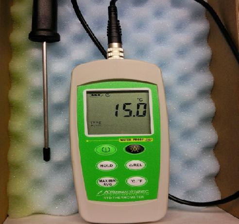

Guys a Pyrometer/Thermometer like this.
A worth while track-day tool?
Do you have one?
Useful for checking other 964 related temps. If so what?
Would you look the tool using one at the trackside
and something best left for testing the Christmas turkey?
Your thoughts please.
Andy.
Possibly, but it's probably much easier to use the infra red type as you then don't need to get as near to potentially very hot bits!!
I used to use one similar to the one in your picture to stick into tarmac to check it's temperature prior to rolling (is that one designed to just touch the object in question or actually be stuck into or immersed in the object?).
In order to learn something useful with a pyrometer you need to be fairly committed and have an assistant to help. You really need to get the temps as soon as the cars stops. Then you need to run around the car, take 3 measurements per tyre. Outer/middle/inner and log them down. (also take pressures).
Then you can work out a few clever things
1) are you working the tyres enough (manufactores will tell you operating temps) or too much, i.e. overheating them
2) are your tyre pressures right (hotter in centre, pressures too high and vice versa)
3) is your car setup right, are temps level between inner and outer? I.e. is the camber right?
4) are you getting enough grip front and back i.e. are the fronts at same as rears? Fronts higher would indicate understeer and vice versa.
All very useful, but you need to be a good driver once you are at that level. And the bits above are kind of the starting point.
Oh also, a warm down lap isnt really going to be part of this routine. Bang round the lap - pit in - crew take measurements. slight pressure adjustments (whilst you are sat in the car) Bang out again!
Oh and infrared ones are not as accurate, as they only measure surface temp.

you need a decent contact pyro for this - you may have seen me offering this service to a few of my customers at the RS day at Oulton recently. You need one which probes at least 2mm into the rubber to get a decent reading.
If anyone is interested, I generally work with groups of up to five people at a trackday for a modest cost per person, not only will it give you the correct pressures to run, it will also analyse your geometry to see if you have too much or too little camber
