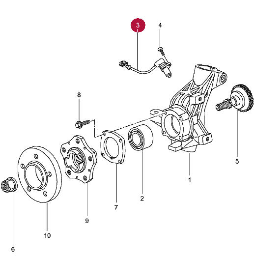

That's the one indicated in the diagram above. There is anly one speed sensor per wheel.

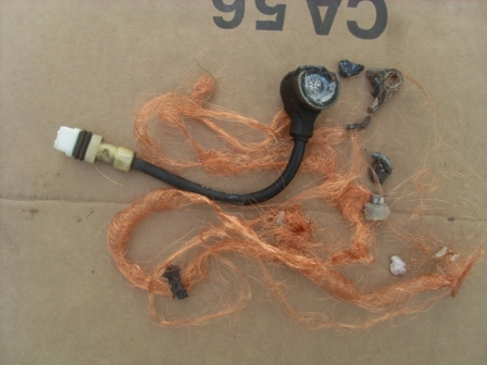

Well what a swine to get the old sensor out, in the end it was not pretty...as per pic.

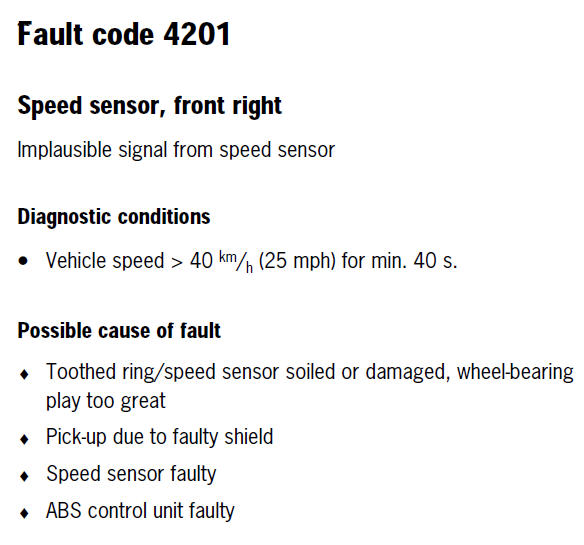

Put the Durametric on it & now its shows code 4201, cleared the codes turned it back on no lights ,reversed out of the drive across the road to the opposite kerb & rolled forward back into driveway no lights?
Jeez this getting a right pain.The ABS kicked in once during low speed braking and the PSM and ABS lights did not come on, I had at that point only travelled 20yds from my drive.They did come on when I travelled into the next road & reached a higher speed (20 - 25mph)they came on & have stayed on. I am going to walk the dog , when I come back I will take sensor out again & try too clean up the area where the sensor fits into with a magnet & brake cleaner spray, I am hoping its just debris left when I had to break up the sensor to get the thing out, worse fear is that I have managed to damage the toothed ring ?? Richard thanks for walking me through this, top man as usual
ETA: Still 4201 ?
