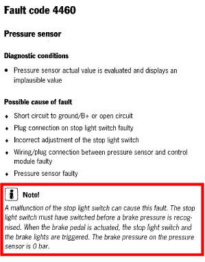

The car was connected to a Porsche diagnostic tester at an Indie at the weekend, with the fault indicating as an ABS presuure sensor. The guy with the tester suggested the brake light switch was in the same circuit & was far more likely to be the cause.
Since then, I've been paying far more attention to when the warning first appears & it does appear to be very soon after the brake pedal is depressed - re-inforcing everybody's suggestion it is the BLS (although as an afterthought, a faulty ABS pressure sensor would possibly also cause a system fault at the same time).
At the cost you've indicated I think I'll be buying / trying the switch first !

I'll bet £1 to 1p that this was the fault code:
Richard,
I didn't see the actual screen detail / fault code - but the technician said it was an ABS pressure sensor fault.
