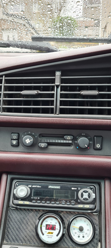

Update on this guys. The new switch I had, with the very very worn decals worked fine. I actually printed off the symbols to the right size, trimmed them, and carefully sellotaped them on to the buttons. Looked quite good but the sellotape really glinted in any light which wasn't great. Also, at night, the illumination had become incredibly faint. Can't have that can we?
So was gonna try and remove the stickers off my old button, sand the new button flat of black paint, and try and carefully re-attach the original stickers. However, I decided to take apart the old button first, to see if I could maybe transplant the good button at least. It became quite apparent once I popped it apart, that I could simply re-attach the broken button with some super glue. Then after a bit of Heath Robinson (which is always fun) I was able to cut a little section of a tie wrap to glue in the side to act as the button stop, so the button didn't pop out 3 or 4mm when disengaged. With minimum fuss, and at first attempt, it was a glorious success! Now fitted back into the dash and I have a perfectly good spare button albeit having a decal crisis!
And that AFR reading is from cold start before anybody tells me I'm running rich! :ROFLMAO:
Stuart
