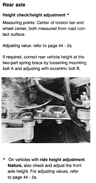

Here's an excerpt from the factory manual showing the eccentric and locking bolts for rear ride height
I think you might be struggling to adjust your rear ride height by as much as 30mm on the eccentrics alone. I can't reacall the total adjustment the eccentrics are capable of but it is not as much as 30mm, and bear in mind their current setting will already have eaten up some of their adjustment range so are unlikely to be on the tallest setting.
Torsion bar adjustment is a pretty simple job in principle however it is one of those very time consuming and tricky jobs. It takes an experienced independant a good 10 - 12hrs labour with a ramp. My car is currently in the shop having the rear ride height lowered for rear coilovers, I did consider tackling the job myself but after reading the procedure I very quickly decided that I didn't want to be stuck under the car for days on end, battling with siezed as stuck bolts that havn't been disturbed for 20yrs. There are a couple of guys on this forum who race 944's who have alot of experience with messing around with TB's. If you use the search function you might pick up some useful tips.
