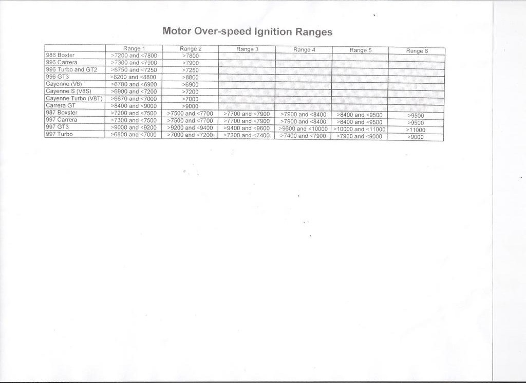

The official information, courtesy of Exeter OPC, is as follows:-
Over-revving in ranges 1 to 3 is perfectly O.K, over-revs in the range 4 to 6 are potentially engine damaging.
Alan is correct in saying it is possible to over rev the engine on PDK in manual with sports/sport plus mode on.
The PDK can also be ove- revved in certain conditions, for example, coming down a steep incline very quickly in low gear with the momentum and mass weight of the vehicle causing an over-rev situation.
Regards,
Clive.
For further clarifcation, whilst it's possible to record an over-rev. situation in sport/sport+ in PDK manual mode, Exeter OPC report they have never seen anything above level 2 - even on hard tracked cars, and this is within the acceptable range for Porsche.
