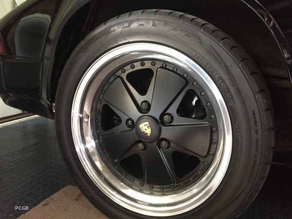

in 1988 it is almost certain that you car would have been specified with Fuchs 16 ,7 and 8s. The finish would be Anodised rim ..dull silver grey ish and satin black centres .Fuchs were actually an option as the factory spec was I think tele dials but 99% of uk market cars were fitted with Fuchs.
you can buy originals from Porsche ..at a hefty price, or there are some jolly good replicas in the market at sensible prices. Suggest to speak to Matt at Type911 .
My wheels are originals in reasonable condition. Fanatics would have them refurbed but I like the patina they have. I’ll see if I can find a pic. Hope this helps
Graham

Hello Ray, I would concur with Graham on his description of the finish, and suggestion the Fuchs for your year would all be 16" diameter - Front 6J and Rear 7J. Spanner in the works now - you have recorded your car on the Register as a wide bodied SSE model. These models would have wider rims Front 7J and Rear 9J. Steve
Hi all,
Thank you for the photo, and advice. Mine are 17" two piece, manufactured by Image in Birmingham, purchased by the previous owner via Paul Stephen's.
Look great, but just thought as 'loads of money' has been spent recently, that a set of Fuch wheels should be added for originality!
