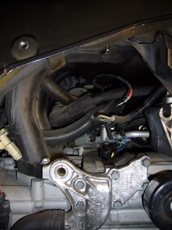

I can also see why the regulator failed, the cooling fins are pressed up against some plastic flexi conduit allowing zero airflow and hence eventually causing an overheat. Especially in the tight engine bay. Silicon hates being overheated.
You can see the crushed conduit in the attached picture.
The charge warning lights are now off after a long a bitter struggle to get the alternator back in and I see a healthy 14V across the battery, even with all of the energy guzzling extras on.
