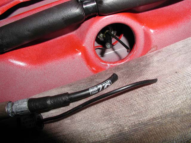

Right, job done!
All in all, pretty straightforward. First step after removing the headliner behind the sunroof was to have a go at loosening the nut holding the base of the aerial in place. A pair of long nose pliers will fit, but in my case the nut was seized and I couldn't get enough leverage.
So, the only way to do it was to cut the wires and put a deep socket on it (17mm 3/8" drive deep socket, about £3.50 from Halfords). It's ok to cut them as the new aerial comes with wires of sufficient length:

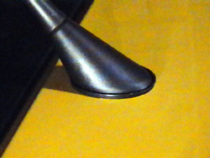

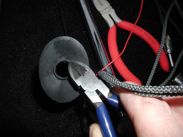

Then, it's just a case of pulling out the old aerial and inserting the new one. First complication: the threaded shaft on the base of the new aerial isn't as long as the old one. Basically, this meant I couldn't get the retaining nut to 'find' the thread. I got around this by trimming the "˜lip' off of the rubber seal that goes between the aerial base and the roof. This "˜lip' covers part of the thread, so removing it meant the threaded part became effectively longer, so I could get the retaining nut on:
I attached this using long nose pliers, as obviously I couldn't use the socket with the new wires in place. No problem, as the new threads obviously aren't corroded, so the pliers gave enough leverage to tighten everything fully.

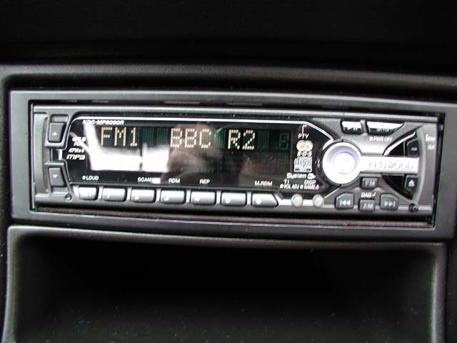

End result "" great reception! I was particularly impressed as other owners have complained of poor reception even when the amplifier is working. With the new strong signal all the RDS gubbins works as well "" station names and all [:)]

I hit the same problems you did - and had to trim the rubber seal to get the nut to bite as you described earlier.
But my main problem was getting the aerial tightened up properly. I eventually went out and bought a couple of spanners and new pairs of pliers. The ideal tool in the end was a pair of 6" pliers which just fitted into the recess and opened just enough to grab the nut.
