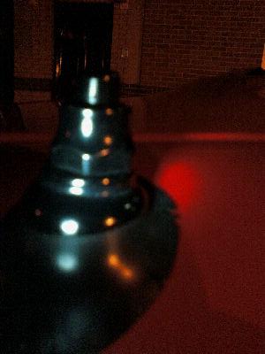

If its a case of taking just the aerial out to give it a clean - can you do it from the top? I see there what looks like a 'nut' shape that a wrench might go around ..........
See attached pic
Before I attack it with tools and make a hash of it ... is that actually a nut you can twist off and get the aerial out to clean?

Although it's been a while, on every aerial I've ever fitted that would be a nut that you could remove, although they are often rusted in place too, so take your time and maybe soak it in penetrating fluid for a while before giving it a go.

The aerial is secured in 2 places, by the nut at the top and by a securing strap to the inner wing which has something like an M6 stud. There are also 3 wires which pass through the inner wing via a bung. If the aerial has been messed with before the inner wing strap may be missing (it was on mine). You really need to take the wheel off to get at it properly. New electric aerials can be had on ebay for around £35. I fitted a Hirsch manual aerial to mine which I got for around £20 off ebay.

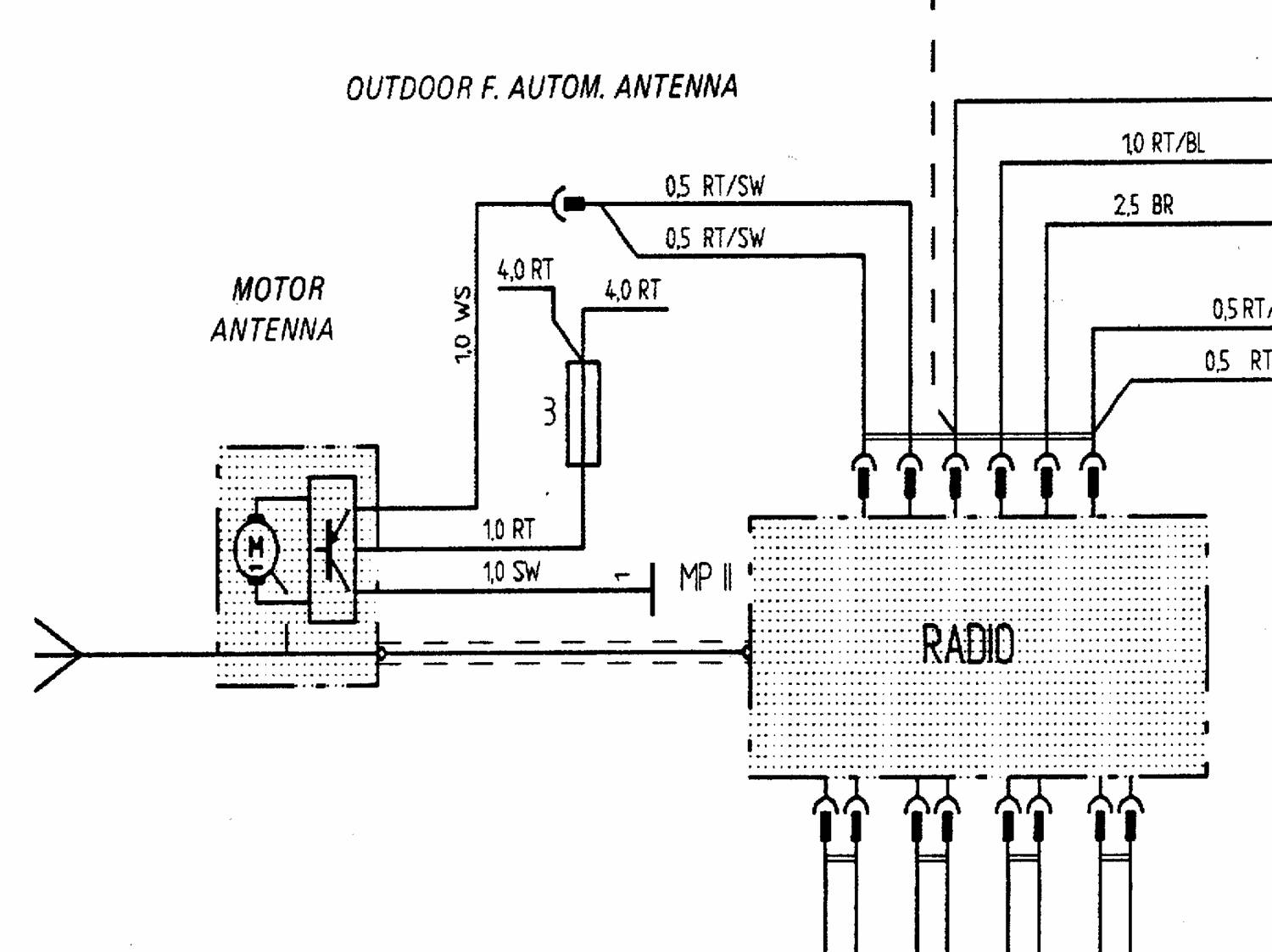

My aerial is electric, but I always leave the fuse out as if I install it, the battery drains overnight. Not being an electrics whizzo, it obviously means the aerial motor is constantly on, but as I can't hear the motor of the aerial buzzing, I have no idea what to look for? I have a multimeter btw

For Black Beauty.
Here is the drawing. Looks like if the diode part of your aerial fails it could cause a current flow that flattens your battery.
