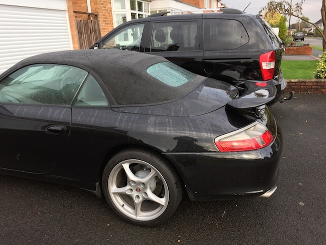

so I just bought a complete boot lid with aerokit spoiler for my 996 gen2
I'm told a straight forward swap. it comes tomorrow.we'll see!
I am hoping the connector for the fan (that also actuates the active spoiler - which the aerobat doesn't have) just plugs in.
I am wondering too what will happen when I go over 75 - will the 'spoiler not deployed' light come on?
has anyone here fitted one of these to theirs?
OK all fitted. straight forward swap. no issues. Came with a blanking plate to go over the rear brake light.
The spoiler light comes on for a few seconds after starting engine so after that it goes out so no problem.

my new wing is fixed so no issue with worrying about raising.
the harness that came with the wing just plugged straight into the existing socket that the old wing/harness plugged into.
this is to power the brake light in the wing.
the old second brake light in the boot is covered with a blanking panel
Note: fitting my wing was very easy since I bought a complete boot lid with wing.
Salvaged I presume from a wrecked car
So I just unbolted the 4 hinge bolts and swapped
