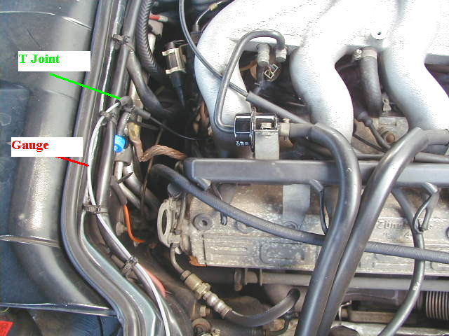

You can then run your new pipe through a grommet in the engine firewall and it appears above the accelerator in the footwell. I couldn't find any t-pieces locally so had to get a rubber Y-piece from Porsche like the two we already have on our vacuum pipes 928.573.727.02 for nearly £4 [8D]
I managed to break that little blue valve you can see in the picture so be careful. It's £18 and Porsche couldn't even identify it. JZ Machtech knew what it was and kept them in stock as they get very brittle.

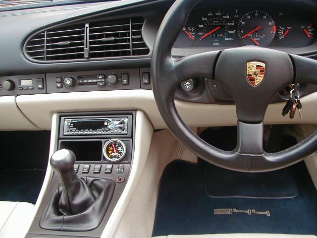

If you decide on one of the Autometer range of gauges, I found the best prices were from www.vwspeedshop.co.uk I paid £39 inc vat for mine with the silver bezel. I really wanted a black bezel one as it looked less ostentatious but they had none in stock and quoted 2-3 weeks from the States. I'm not that patient and the silver one came next day [

Silly me, I never thought of VDO, I've ordered a CAi guage through Demon Tweeks (-1 to + +1.5 bar) it was the most "original equipment" one I could find.

The ideal solution would be someone who could remap the in-dash gauge to have a larger range and be more accurate
