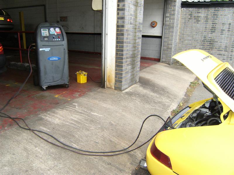

The equipment that Kwikfit in Bletchley used for my car was an Autoclimate AC658 Pro - it didn't have a Kwikfit name on it at all. See the attached pic.
The real benefit in my book was, apart from the price, the fact that the system is evacuated and re-oiled. If the system is just "topped-up" by adding more refrigerant there is no way of knowing how much is in there - it can only be judged by monitoring the pressures - and that's not really good enough to ensure that the system is fully charged.
