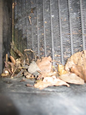

Any idea what the cost of the condensor is? Mines leaking too. When it was re-gassed last year they added a leak detectant to teh system. The lower corner of the condensor is green from the leak detectant.
It's also covered in muck quite badly and there were quite a few leaves in the duct. That can't help efficiency!
And here's why you should clean the condenser from time to time...
The green stain is from the leak detectant.
(Remains of dead bird removed prior to picture!)
