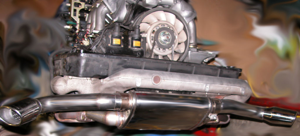

I cant get a picture as its to far hiden away, its nothing to do with the exhasut but lies immediatly above the Cat (bishoff) this is a cast alluminium tube that connnects to each side of the heat exchanger on the manifolds, I looked on the pasrt register and I think its called the air distribution tube
Adrian, Ok - found it in the parts cat. Picture you found makes it look a lot more substantial than the catalog! I think I've reached same conclusion as you, that it's "only" for transporting the air that heats the interior. In a few seconds someone else will be along and tell me I'm completely wrong. How badly damaged is it?
Its completley blitzed in the middle, when looking at it I dont even think it will make a great deal of difference as the heater pipe work come off the heat exhanger in the completley dfifferent place, from what i can see it looks like it collects extra heat from the top of the cat and feeds it back to the manifold heat exchanger????

HI , The tubes job is to feed the cool, fan driven air into the heat exchangers so that it maybe heated before its pumped forwards in to the sills via insulated tubes for use in the heating system. If it is split then some of the air will be lost and the heating system may be inefficient, wrapping some material around the break would be air tight enough to restore its function (exhaust wrap or some thin tin). as Chris said should be available used,as its not a part which ever fails except when damaged by an impact!
