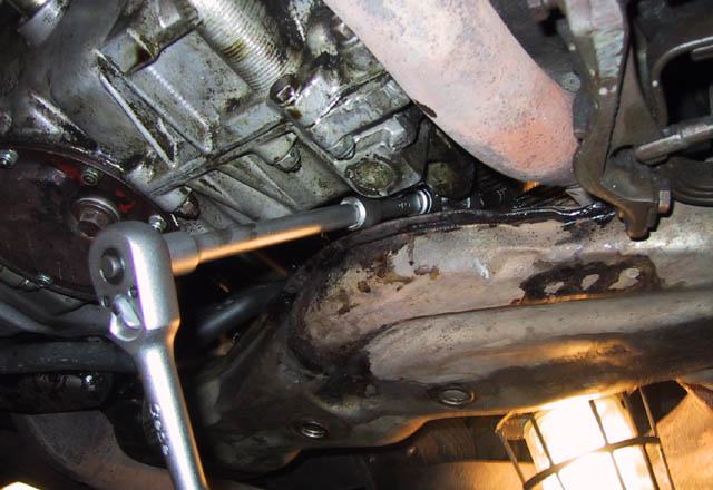

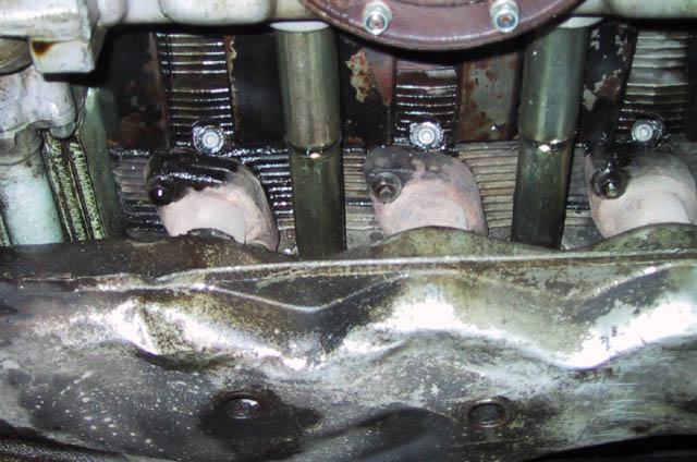

It's not too hard but it's easier without the heat exchangers in situ'. After you have undone the air pump brackets and junked the horsepower sapping piece of junk it's under the car to trace the pump lines which as you might know run longtitudinally with the heat exchangers. It's hard to see from the pic but after applying some heat you have to unbolt them from the engine , (can be tricky) and plug the holes left behind, you can get the plugs here

Thanks Bones and Jeff,
Thats made the job a whole lot clearer, especially looking at the pictures.
