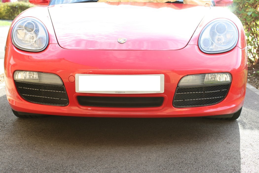

Here is how I fitted mine to a pre 2003 model:

Cut mesh roughly to size as shown here:
http://i529.photobuc...00/DSCN0976.jpg
Lay the mesh over the intake and just form with your hand to its contours.
Drill 6 small pilot holes and fix with self tapping screws.
http://i529.photobuc...0/MeshScrew.jpg
http://i529.photobuc...er1000/Mesh.jpg
Trim excess mesh off where it protrudes beyond intake
http://i529.photobuc...00/DSCN0990.jpg
Refit bumper and you're done. No more debris in your radiators.
http://i529.photobuc...00/DSCN1021.jpg
This does look neat.
I did mine a couple of years ago but went for the outside mount instead of pulling off the bumper.
